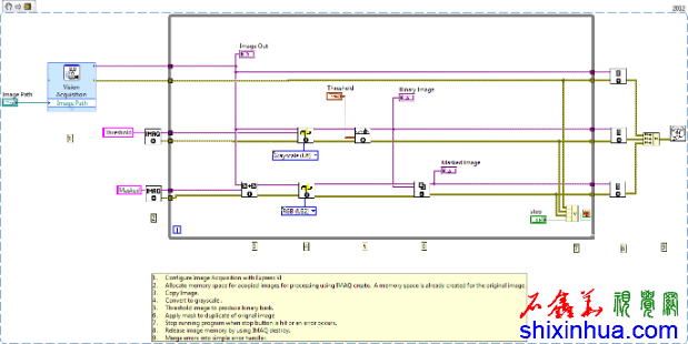

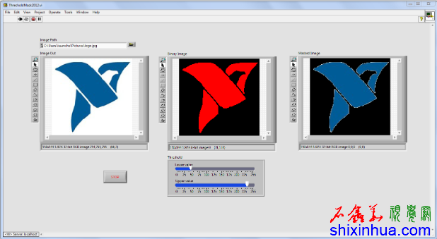

    Description:
    This program uses vision acquisition software to grab an image from a specified path and allows the user to apply a threshold, generating a binary image.  This binary image is then used to mask the orignal image and segment a region of interest.  This method is used for separating the foreground from the background of an image.
    Instructions for Running:
    1. Select the file path of the image you wish to threshold on the front panel.
    2. Run Program
    3. Adjust Lower and Upper bounds of threshold to suit your needs.
    4. Stop when you wish to end session.
    threshold
    threshold
    thresholddiagram
    thresholddiagram
