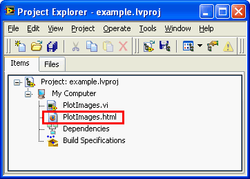

    4.
    LabVIEW项目浏览器中, 右键单击我的电脑图片选择添加文件添加HTML文档到项目中. 找到你新生成的HTML文档并将其添加进来.

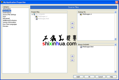

    5.
    右键点击 程序生成规范 新建 应用程序来生成可执行文件. 选择源文件 部分将顶层VI添加至启动VI 并添加您的HTML文件至动态VI及支持文件. 点击生成按键生成您的可执行文件.

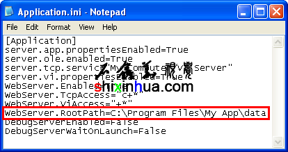

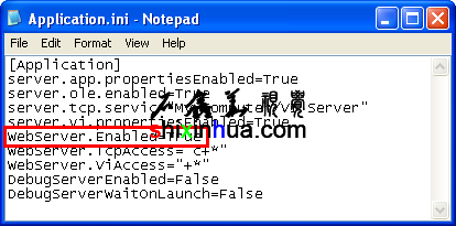

    在你的目标机器上找到应用程序存储的目录. 打开.ini 文件.
    (1)添加WebServer.Enabled=True这个键值 到其他WebServer键值之后.
    (2)
    web server root path从原来的[LabVIEW]www改为现在您的HTML网页所在的目录(它应该在您的应用程序所在的data目录下).
    (3)保存对.ini 文件所做的修改并关闭文件.

    • Save your project and build your executable by right-clicking Build Specifications andselecting NewApplication (EXE). Select the Source Files category. Then, place your top level VI under Startup VIs and your HTML file under Always Included. Click Build and then clickDone when the build is complete.

    • On the target computer, browse to the directory where you just copied your executable. Open the .ini file in a text editor and perform the following:
      • Verify the token WebServer.Enabled=True exists. If you cannot find it, add it to the end of the file
      LabVIEW 8.x prior to LabVIEW 8.6:
      • Add or modify the WebServer.RootPath so that its value is set to the directory where the HTML page currently resides (it should be located in the application's datadirectory)
      • Save the changes to the .ini file and close it

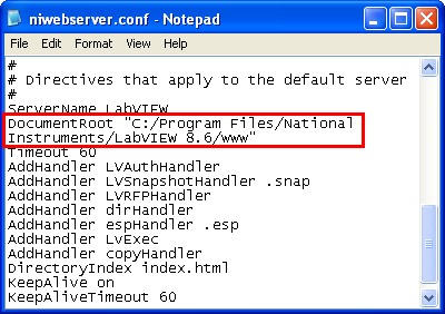

      LabVIEW 8.6 and later:
      • Close the .ini file and open niwebserver.conf in a text editor. This file was created to handle the new functionality provided by the LabVIEW web server in LabVIEW 8.6
      • In the second section labeled Directives that apply to the default server there is aDocumentRoot tag. Replace the default LabVIEWwww with the location of your HTML file. Do not include the name of the HTML file in the path
