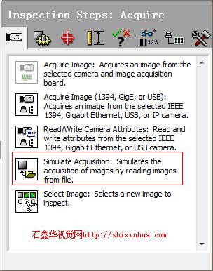

    5.   Simulate Acquisition: Simulates the acquisition of image by reading images from file.
    VBAI Help:Simulates a live acquisition by loading images from file. Vision Builder AI ships with several images you can use as simulation images. You can find these images in the \DemoImg directory. You can also load your own images as simulation images. Refer to Simulate Acquisition Concepts for related information.
    读取图片进行仿真采集,然后进行图像分析处理。这功能对于入门学习者非常实用,可以不需要花大成本购买相机、镜头、光源等硬件,即可学习VBAI。点击此函数后,出现如下图3-21所示的仿真界面:
