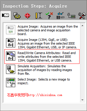

    3.   Read/Write Camera Attributes:Read and write attributes from the selected IEEE 1394, Gigabit Ethernet, or USB camera.
    VBAI Help:Reads or writes camera attributes for an IEEE 1394 camera, GigE Vision camera, IP camera, or DirectShow-compatible USB camera.
    针对1394相机、千兆以太网相机、IP相机、或直接显示兼容USB相机进行读写相机属性。利用此函数,可以针对相机属性进行操作,并且通过Grab实时查看属性更改后的采集图片效果。如图3-17所示。
